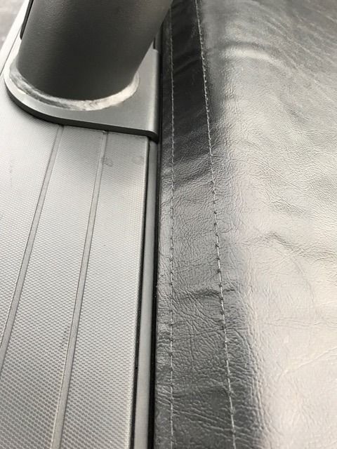

1. first pic shows the gap between the sport bar rear post at inside of bed. this needs to move up against the bed side.
2nd pic shows sliding it into gap in weather strip. looks like the picture got turned around
3rd pic shows the rail fitment and the tonneau rolled behind bars. not able to roll to the back without angling it (see next to last pic #5).
4th pic shows closed and fit on passengers side by sport bar.
5th pic shows fit on drivers side by sport bar.
6th picture shows it closed. see the fit by the passenger rear sport post. looks good.
7th pic shows trying to angle it to get past sport bar.
I think it will work for me. I wish it was easier to get past the rear sport bar post.
