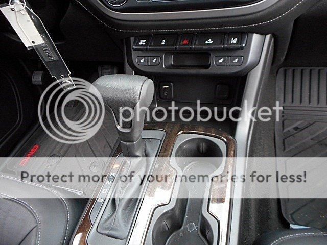

I was just looking at a used SLT at the dealer (the sales guy said he didn't know why the seats had these tabs showing) and I snapped these pictures because I didn't understand what I was looking at. Seems like you guys have been able to fix yours but what is GM saying? Is there a recall on these? I hesitate to buy this vehicle because the tabs are both sticking out..
directnosfogger is offline
