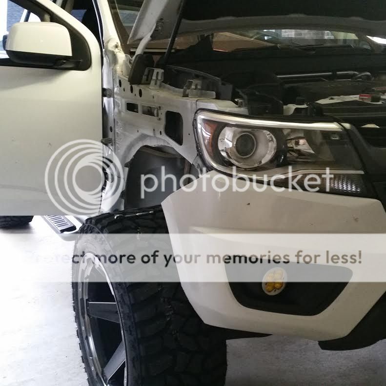

On a different note: got the wheels and tires mounted up and installed! Needless to say.... I'm now having to "make them fit"
Still got a good bit of work to do to complete this "makeover".... but this was definitely the biggest hurdle, considering I had no idea what I was getting into when I decided to run this big of a wheel/tire setup. But, I don't mind a challenge and the outcome was definitely worth it! Better pics to come once Hurricane Matthew decides to stop beating up ol' SC!
Proper way to trim fenders... pull them off the truck!
Still got some work to do on making these fender flares work...

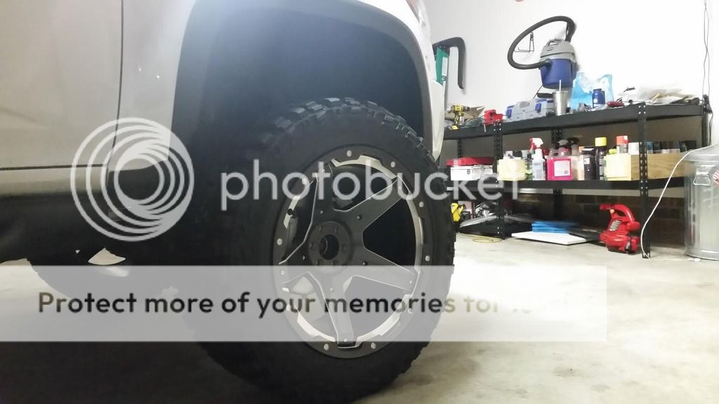

I'm not sure you'll be able to fit a 10" wide wheel with a +25.... I foresee you hitting the front calipers. My last setup was a 20x10 -25 and I had maybe a half inch between the spoke and caliper..... so you're +25 will be sitting another 2" inwards than my setup. And in my personal opinion, why go with a custom wheel and choose a wheel that will sit sunken into the fenders like the OEM wheels do? I'd at least do a +0 offset.
Here's a pic of my 20x10 -25 to show you how they sat with the fender:
