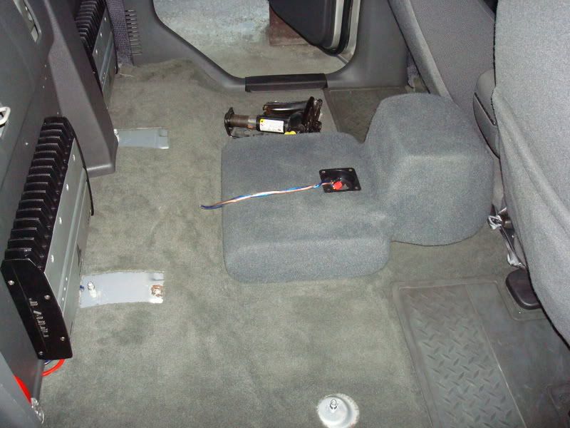

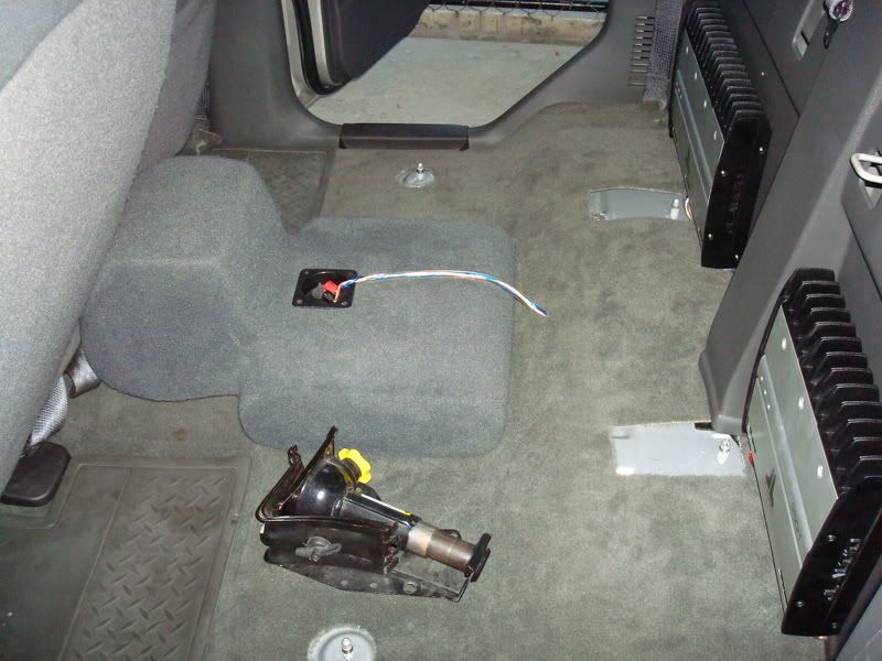

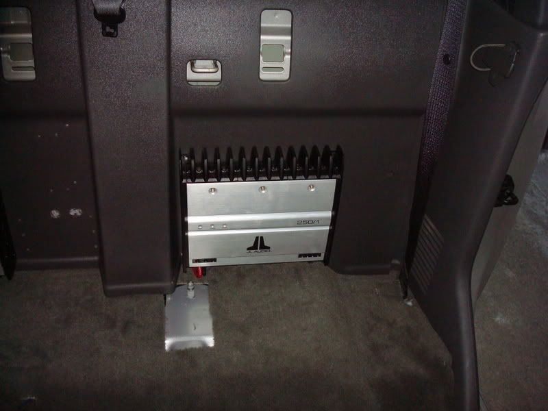

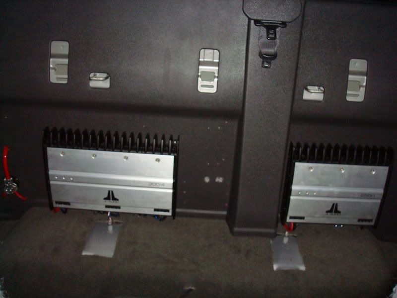

post #19 of 20 (permalink) Old 05-18-2008, 12:31 PM
Location: Belize City C.A.
Posts: 1,172
Send a message via MSN to Belizeanlow Send a message via Yahoo to Belizeanlow
Re: Crew Cab amplifier installation location
here is mine with my jl audio amps:
