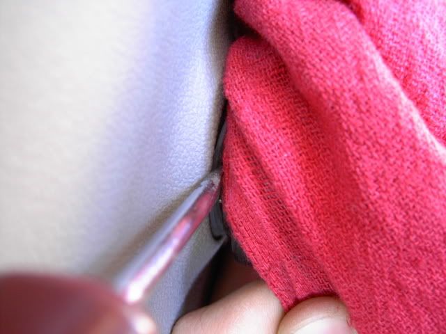

First off, I put a flat head screw driver in behind the window crank to make space between the window crank and the plastic ring so the rag will squeeze in there.
Here is a close up pic of where the screw driver needs to go and you can see the clear plastic ring that needs to be pushed back.
Now take your shop rag. Hold one corner in each hand and slowly work it between the crank and the plastic ring as you can see in this pic.

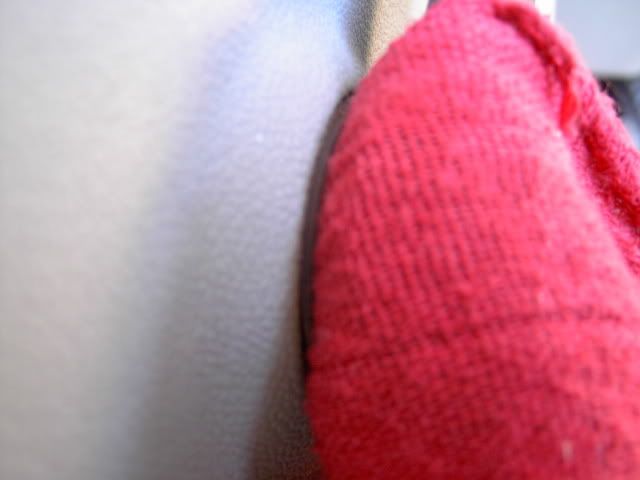

Now after you make sure that the rag is in place, remove the screw driver. If you look closely you can see the rag in between the plastic ring and the crank.
Now that the rag is in place, you can start doing the shoe shine thing with it. Make sure that you are holding on to the corners of the rag as you go back and forth. You might have to move the rag around in order to grab the clip. Once you get the clip off, you will notice that the crank pops out slightly. Once you pull it off, you will see this.........

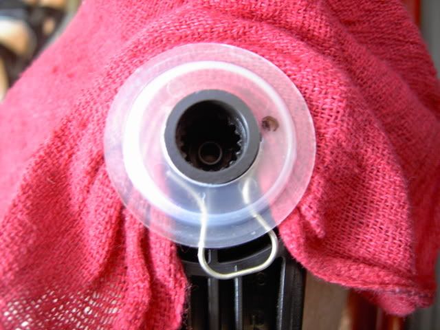

This little clip is what is keeping your window crank in place. Once the rag grabs ahold of it and you do your shoe shine technique, it will come off.
Upon reinstalling the window crank, you must remove the clear plastic ring, reinstall the clip into it's slots(you can see them if you look closely on the crank), then reinstall the clear ring. At this point, all you have to do is to push the crank back on.
