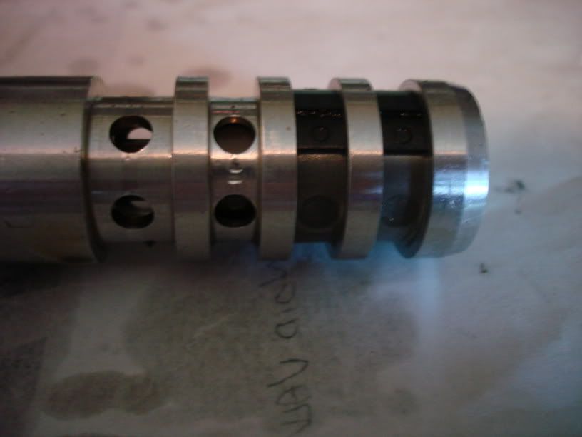

Yeah there was the thread at the top of the page with some pics and info. Here is the pic another user posted of the good part. Also if you do a search in the forums for P0014 and P0017 you'll get lots more info on the problem. Those are the error codes you get when one of the screens disintegrates. On a side note after replacing this part my truck is idling better than it EVER has. It used to fluctuate a little (20-30RPMs) even when the A/C was off. GONE. Goodluck. Any more questions let me know. If you have time to spare for shipping you can order the part from Gmpartsdirect.com. Do a search for part 12602516. Save you from having to get it from the dealer at $96. And NO auto parts store has this part yet. I went to NAPA, Autozone, Schucks, Baxter, and Knechts.

the picture of the gold colored sensor, is that the new one or the broken one?

THats not actually a pic I took. Mine was all silver with dark grey screens. But that pic is of a good part that has all the screens intact. You'lll know it if one of the screens is missing.
